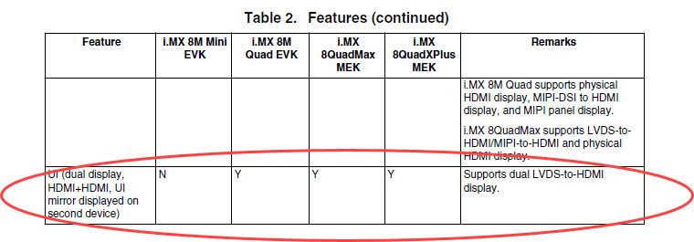

diegoadrian
I apologies, that was my mistake. I was referring to the i.MX8MQ instead of the i.MX6Q. Unfortunately, the dual-display with different contents is only supported by our Linux BSP. Android does not support dual-display.
If you go to the Android release notes document, Table 2, page 4. You could find that only the mirrored dual-display is supported by our Android BSP in the i.MX8MQ.
I apologize for the inconvenience this may cause you.
Diego.

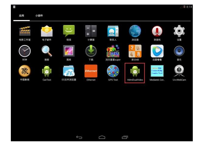

hongxingyu1982
Hi Diego
I see there is a apk HdmiDualVideo can setting the different context with dual dispaly in
iTOP-iMX6 board, as blew:
But It seems there is no this apk for imx8mq, why ?
Br
4,580 Views
diegoadrian
The iTOP-iMX6 is a board from a third-party. For specific support of that application, I suggest you go with them. I apologize for the inconvenience this could give you.
Diego.
