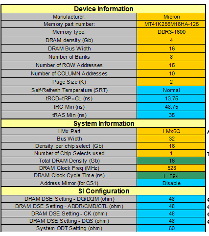

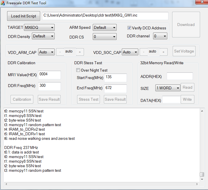

Hello all
         We had designed a custom board based on imx6qsabre-AI , now we have 4 boards with test ,
we use " I.MX6DQSDL DDR3 Script Aid V0.10.xlsx " and "DDR_stress_tester_v2.52" config and test ddr3
but  4 boards calibration not the same result .
1 how can I find a calibration result suitable for my board (Late mass production of the board )

lixuhui112
yes ,my ddr config is refer Freescale i.MX6 DRAM Port Application Guide-DDR3 , and I use the config file to calibration is ok . my means is :
I have  4 boards calibration not the same result .
2 now I one calibration result in uboot ,but the uboot load the kernel and file system always appear : Unable to handle kernel paging request at virtual address a8abca4e ,
