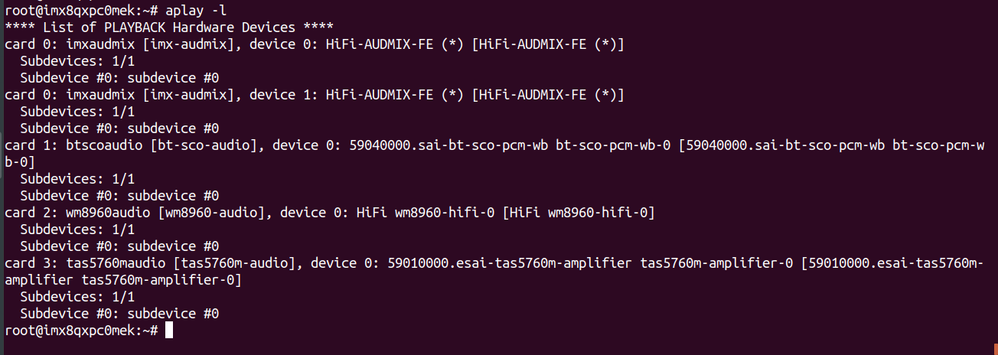

With above entry we were able to create sound card entry
sound card list

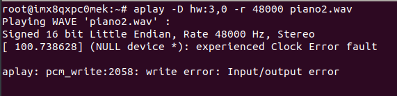

When we tried to play 48000 HZ audio we are facing below error:
aplay command

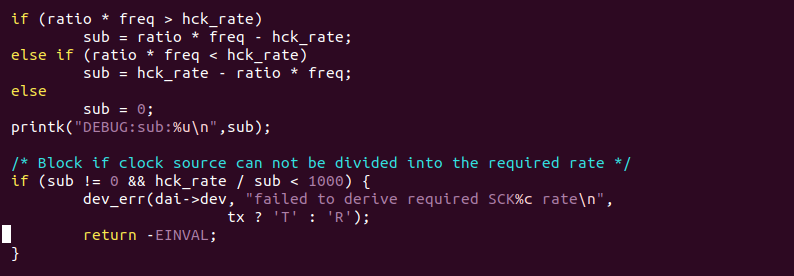

I found that the SCKT rate error is from fsl_esai_set_bclk function, I added some debug prints and checked . The freq value is updated from sample rate and and bit size of audio file . How hck_rate is assigned here.
I used 16 bit, stereo 48000 Hz audio file in aplay command
fsl_esai_set_bclkfsl_esai_set_bclk
What could be the reason for this issue , How to resolve it

JorgeCas
That is related to the target frequency, and PLL driver (It is not recommended to modify this because could affect other modules).
Other thing you could try is change sample frequency when you try to the play audio or use an external clock to get required clock frequency.

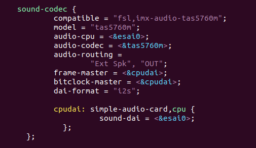

We tried to use ASoC Sound Card similar to wm8960 , So i modified the changes in sound/soc/fsl/fsl-asoc-card.c file. Below is the dts change made asoc sound card dtsasoc sound card dts
and successfully created the sound card list . When we probed, the BCLK and FSYNC is not coming so TAS5760 is throwing a clock error when tried to play the audio file .

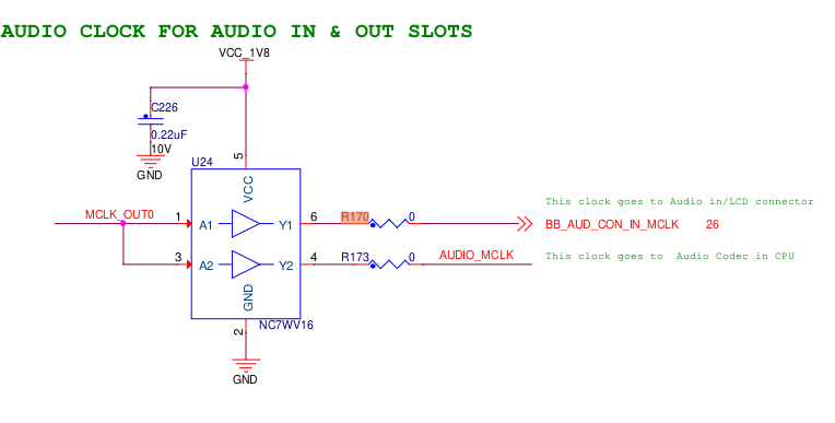

Also MCLK will be generated if we give APLAY command for headset(wm8960) and This MCLK (took connection from R170) is given to amplifier
MCLKMCLK

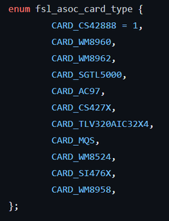

JorgeCas
This could be related to the way you added the codec on the code.
fsl-asoc-card.c by dafault supports the next sound cards.

Anitha1
We tried connecting MCLK externally to audio codec and below changes were made in fsl_asoc_card_hw_params function
fsl-asoc-cardfsl-asoc-card
and in probe function
with this changes and dts entry, able to create sound card list in aplay -l command but
When in run the below command ,BCLK and LRCK signals are not being generated when probed, leading to the Clock Error Status bit being set high in the TAS5760
aplay -D hw:3,0 -r 48000 piano2.wav
Did i missed any configuration,  How to resolve it.

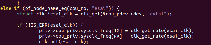

I've added debug prints to the fsl-asoc-card.c file and verified that the system clock for the CPU is sourced from the "extal" property and has a rate of 49152000 Hz. This clock is used to derive the SCK and FS clocks.
fsl-asoc-card.cfsl-asoc-card.c
So I have modified it and ensured that the direction of the clock is set to OUT

Anitha1
The clock error has been resolved by implementing external oscillator for generating MCLK and dai_fmt is adjusted to SND_SOC_DAI_FMT_CBS_CFS for cpu.
With these modification the clock error is rectified
