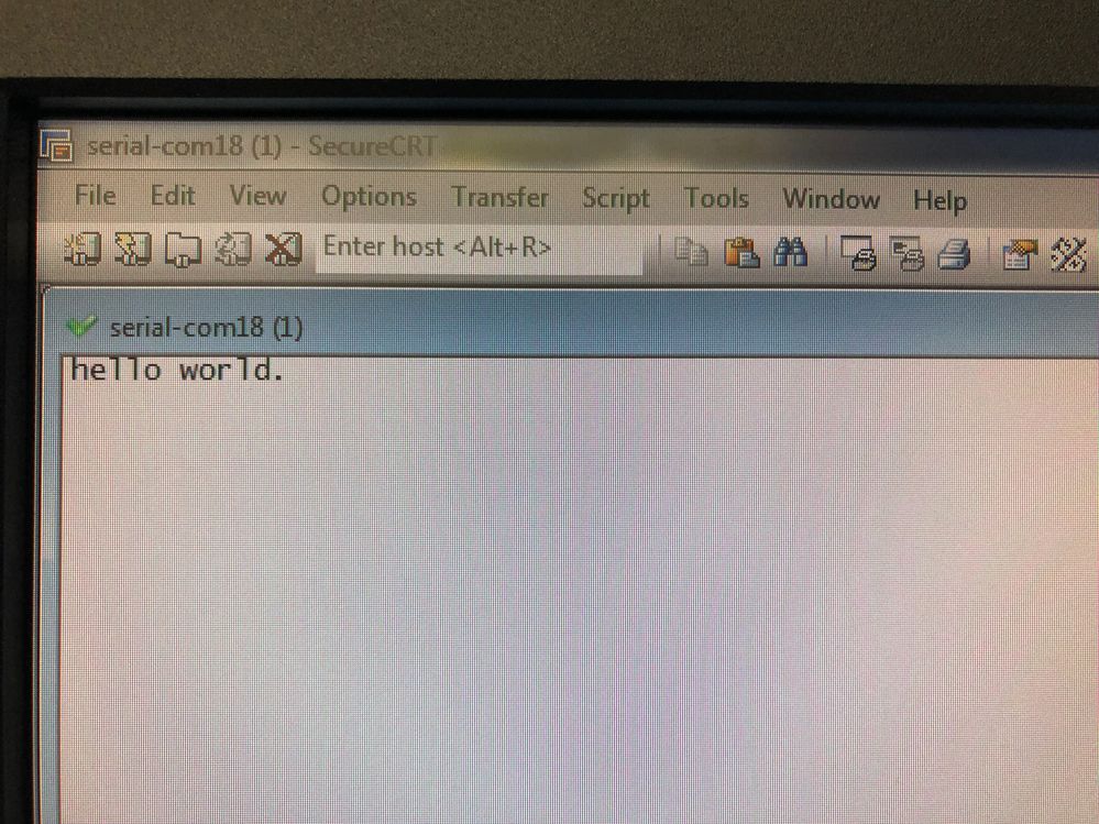

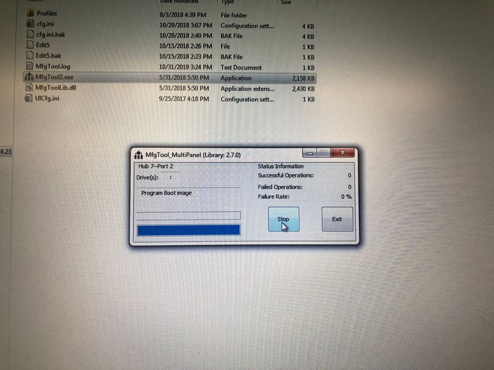

     I use MfgTool2 to download the image to QSPI flash, but always return fail and the failure rate is always 100%.  I have another board and it goes to done.  Does it mean the QSPI flash is broken?

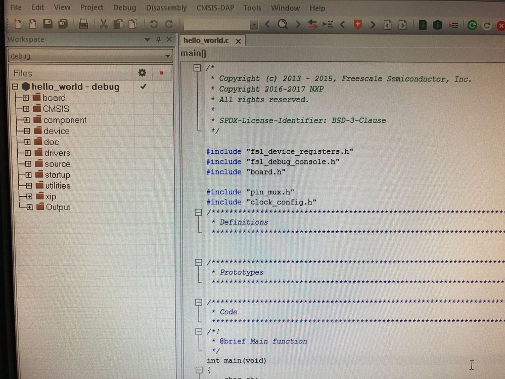

And I use IAR to load hello_world sdram image. It can run successfully and uart can output the "hello world".

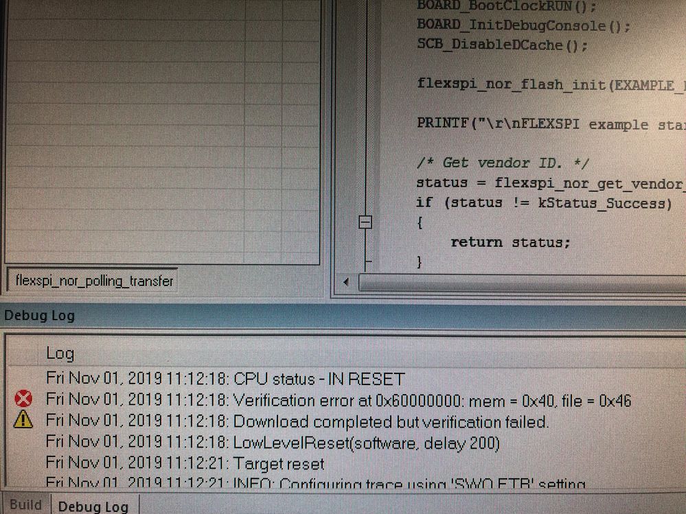

xi_zhang
Hi Jeremy,
      Thanks for your reply.  Yes, these two boards are identical.
      I try to download flexspi_nor_polling_transfer using configuration flexspi_nor_debug and get the below error.  Does it mean some memory broken?
      This error only shows in Serial Downloader boot mode. Internal boot doesn't have the issue. Since MfgTool2 uses Serial Downloader boot mode, it still always fail.
Xi Zhang

jeremyzhou
 Hi XI ZHANG,
It seems there's something wrong with the QSPI flash, please give using debug configuration a debug again to do further validation.
Have a great day.
TIC
