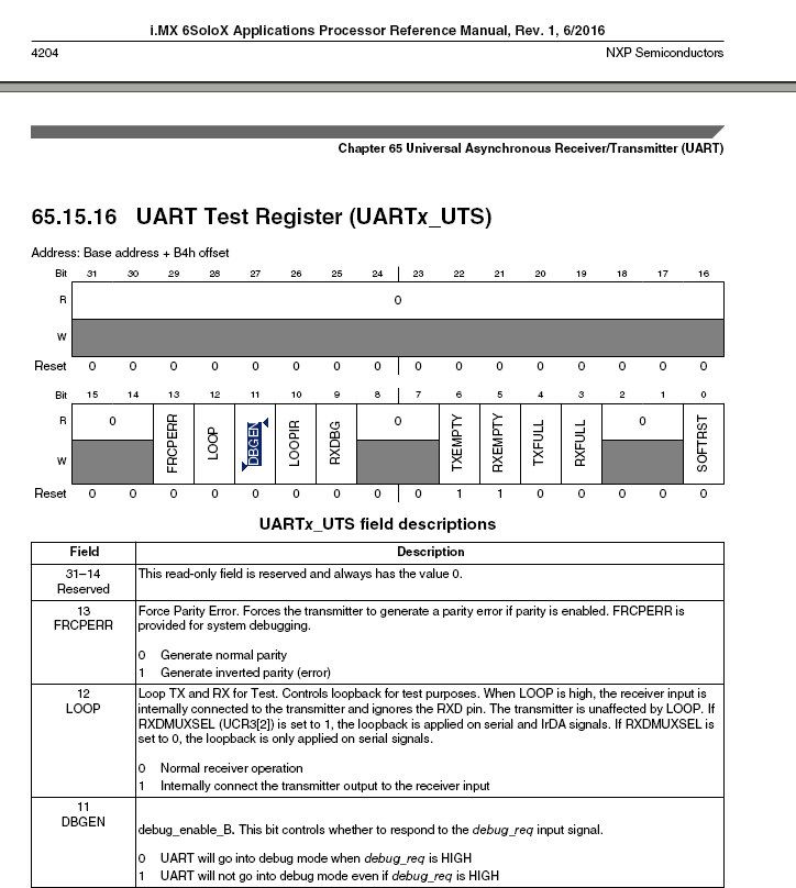

Is it normal that operating system get freezed after finish debugging process with jlink.
I am using a UDOO NEO board, which has UDOObuntu.
When I debug from TCM or OCRAM, after finish I stop the session and ubuntu is freezed, even can not access with uboot terminal console so I assume Cortex A9 get freezed.I need to restar the session again for get control and start debugging.
I am almost sure that peripherals used in my code for m4 are not being used in A9. Suspect sometine with WDT or idle power of ubuntu but I am not pretty sure.

igorpadykov
Hi Jefferson
it does not matter if uart1(or any of mentioned modules: CAN, UART, EPIT,
GPT, ENET, PWM,WDOG) is in domain of A9, possible reason of misbehaviour may be that
when M4 enter debug mode it sets debug_req for all modules, below example for uart:
So one can set DBGEN=1 for all modules used by A9, for not going into debug mode
and keep them running.
igor

igorpadykov
Hi Jefferson
hanging may be caused by that when M4 enter debug mode, the debug_req will also
assert in the peripherals which are used by the A9 system.
Need to configure the DBGEN (*) register in the related peripherals to allow
the peripherals not going into debug mode and keep running even if debug_req is HIGH.
The peripherals which need take care are: CAN, UART, EPIT, GPT, ENET, PWM,WDOG.

jealcuna
I find out the solution.
Background of the main problem:
As imx6sx has a core for A9 and other one for M4, when you perform a debug process with jlink, this will halt both of these cores, in consequence after finish you can not only leave halted the processor because this will stay freezed. We  want to finish a debug process but we want also still using linux for load other code make something on it. Therefore, we will need to be sure that processor M4 is running (not halted) after push the button "Terminate" on eclipse.
Solution for eclipse:
After catch the bug in the code, we need to disable breakpoints and then run the debugging process. After this we can use the button "terminate" placed in console "debug [GDB SEGGER J-Link Debugging] JlinkGDBserverCL.exe".
If you follow this rule of thumb, you will be able to debug a code without restart the UDOO Neo board.
