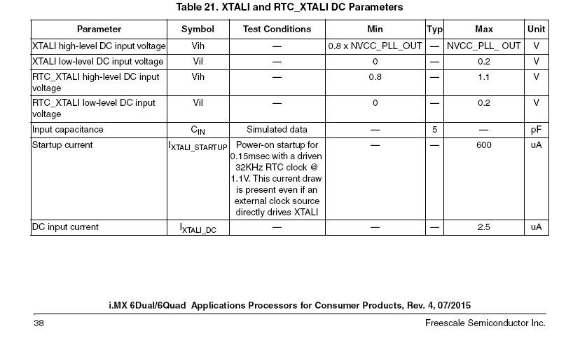

torus1000
Contributor V
Dear Igor igorpadykov
> please check ... and Development User’s Guide for necessary signal levels.
Actually our client use MCIMX7D-SDB.
So I checked IMX7DSHDG.pdf then found follwing description.
https://community.nxp.com/message/820468?commentID=820468#comment-820468
https://www.nxp.com/docs/en/user-guide/IMX7DSHDG.pdf
  For RTC_XTALI VIL and VIH voltage levels, see the
  latest i.MX 7 series datasheet available at nxp.com.
But I couldn't find neither VIL nor VIH in the latest datasheet.
https://www.nxp.com/docs/en/data-sheet/IMX7DCEC.pdf
https://community.nxp.com/message/360353
  Unfortunately we do not have such detail information of the XTAL spec.
(Q1) Did your answer "necessary signal levels" mean VIL and VIH?
(Q2) If yes, where can I get VIL and VIH spec for RTC_XTALI and XTALI pins?

igorpadykov
Hi torus1000
yes
