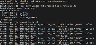

-- testing the switch GPIO
First check if your gpio dts configuration to make it act as a switch works or not
After executing the command - 'evtest /dev/input/event1'
Trigger an interrupt by connecting GPIO2 7 to GND, as soon as you do that, you will receive Event logs such as below:-
This shows that your dts configuration for GPIO works.

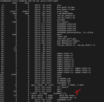

-- Verify the interrupt
-- Go to sleep and then connect the GPIO to GND to trigger a wakeup, in the logs we see that kernel exits the suspend mode
