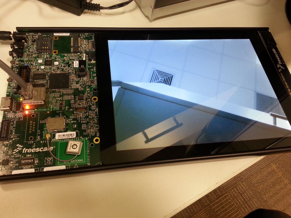

i.MX6DL running mxc_v4l2_overlay.out with only one lane:
