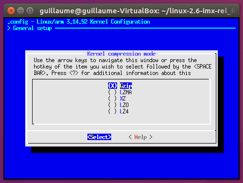

$ make imx_v7_defconfig
$ make menuconfig
$ make -j4 zImage modules dtbs

Thanks for this great post ! My goal is to run an Ubuntu 14.04 or higher on my IMX6Q SABRE SD board from the mmc card. I am following the post.
The following link is not valid any more:
https://releases.linaro.org/14.09/components/toolchain/binaries/gcc-linaro-arm-linux-gnueabihf-4.9-2...
I replace it by the following one:
https://releases.linaro.org/archive/14.09/components/toolchain/binaries/gcc-linaro-arm-linux-gnueabihf-4.9-2014.09_linux.tar.xz
But it does not work, I get the following strange error: (same error described by wenming feng)
/bin/sh: 1: /home/guillaume/gcc-linaro-arm-linux-gnueabihf-4.9-2014.09_linux/bin/arm-linux-gnueabihf-gcc: not found
If I select this toolchain, I can compile:
gcc-linaro-4.8-2015.06-x86_64_arm-linux-xxxx
But I am generating an Image file and NOT a zImage file. And u-boot does not take it (bad linux arm zimage magic error at u boot runtime). It seems that it exists uImage, Image and zImage. Image would correspond to a 64bit image if I understand correctly.
Question 1: Which toolchain or option I have to use/set to generate a zImage ? (and not an Image)
Question 2: Would it be possible to update this post with up to date links ?
Question 3: Is there somewhere an already builded .sdcard for SABRE SD with everything on it (u-boot, kernel, dtb, ubuntu 14.04 or higher ..) ?
Guillaume HUGUES
Basically, I found the solution. To generate a zImage instead of Image, you have to enter make menuconfig and select this option
Gzip is not the defaut choice.
Now I have a ubuntu 14.04 running on my I.MX6Q SABRESD board. Thanks for this essential post !
