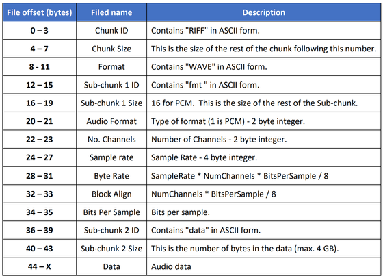

This files starts with a file header with data chunks. A WAV file consists of two sub-chunks:
  • fmt chunk: data format.
  • data chunk: sample data.
So, is structured by a metadata that is called WAV file header and the actual audio information.
The header of a WAV (RIFF) file is 44 bytes long and has the following format:

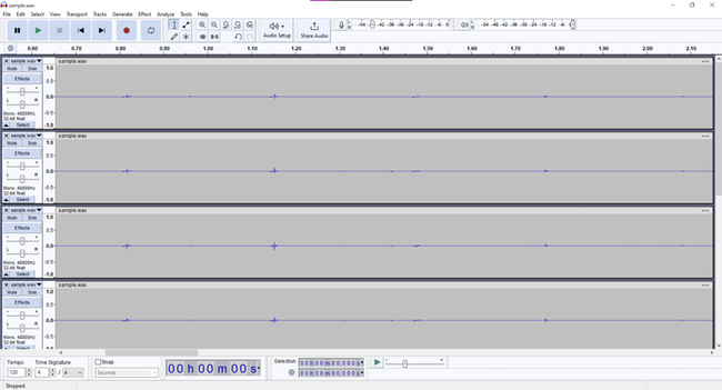

This raw data cannot be used as a “normal” .wav file because the header information is missing. It is possible to confirm it if import raw data to a DAW and play recorded samples:

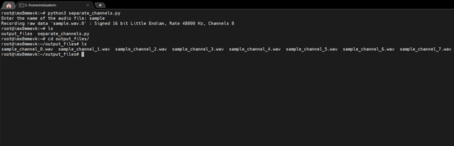

So, to use this information we need to create the header for each file using WAVE library on python. Here the script that I used:
import wave
import os
name = input("Enter the name of the audio file: ")
os.system("arecord -D plughw:2,0 -c8 -f s16_le -r 48000 -d 10 --separate-channels " + name + ".wav")
for i in range (0,8):
    with open(name + ".wav." + str(i), "rb") as in_file:
        data = in_file.read()
        with wave.open(name + "_channel_" + str(i) +".wav", "wb") as out_file:
            out_file.setnchannels(1)
            out_file.setsampwidth(2)
            out_file.setframerate(48000)
            out_file.writeframesraw(data)
os.system("mkdir output_files")
os.system("mv " + name + "_channel_" + "* " + "output_files")
os.system("rm " + name + ".wav.*")
If we run the script, will generate a directory with the eight audio channels in .wav format.
