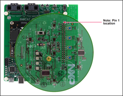

Connecting the i.MX 8MIC-RPI-MX8 Board.
The i.MX 8MIC-RPI-MX8 Board has a 40-pin expansion connector that you can plug it directly to the EVK board. Ensure that pin 1 of the 8MIC-RPI-MX8 is aligned with pin 1 on the EVK J1001 as is showed on the next figure:

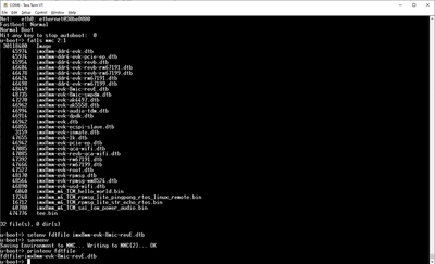

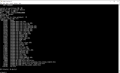

Once the pre-compiled image is flashed on the board (Flashing Linux BSP using UUU) and you connected the 8MIC-RPI-MX8 it is necessary to select the correct device tree to handle 8MIC board. On U-boot check the available .dtb files on the BSP using the next command:
u-boot=> fatls mmc 2:1
And you will get the corresponding list of .dbt files:
 On this case we are working with an I.MX 8M Mini EVK and the corresponding .dtb file is:
imx8mm-evk-8mic-revE.dtb
To select it you need to set the environment variable and save it with:
u-boot=> setenv fdtfile imx8mm-evk-8mic-revE.dtb
u-boot=> saveenv
Doble check it using:
u-boot=> printenv fdtfile

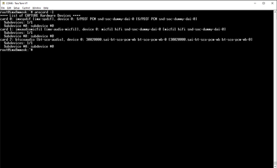

Once we are on Linux, we can check our audio codecs detected on the board using:
arecord -l

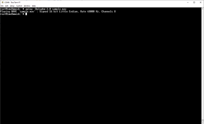

To play our recordings we need to use the ALSA aplay command, it is important to select the correct audio codec to hear the audio from the jack on the board:
aplay -Dplughw:3,0 sample.wav
-D: selects the device.
sample.wav: Is the name of audio file to play
