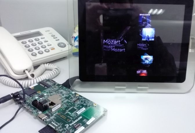

You need to compile OpenVG to run on X11 backend.  However, there is no Makefile.x11 included in the SDK for OpenVG.  Please refer the attached makefiles hacked from GLES2.0 directory (makefiles.tgz).
Also, If you are using the uboot and kernel from L3.0.35_4.1.0_130816_images_MX6, then please do use the Ubuntu rootfs named: L3035_410_ubuntu_rfs_oneiric.tgz and which should have gcc and needed header files installed and does not need to do any modification.
So, untar the makefile.tgz inside OpenCV directory and your will get the additional Makefile.x11 and also inside CoverFlow etc
linaro@linaro-ubuntu-desktop:~/gpu_sdk_v100/Samples/OpenVG$ make -f Makefile.x11 clean
linaro@linaro-ubuntu-desktop:~/gpu_sdk_v100/Samples/OpenVG$ make -f Makefile.x11 install
The binaries could be found in OpenVG/bin/OpenVG_x11
Here is what it look like when running CoverFlow:
