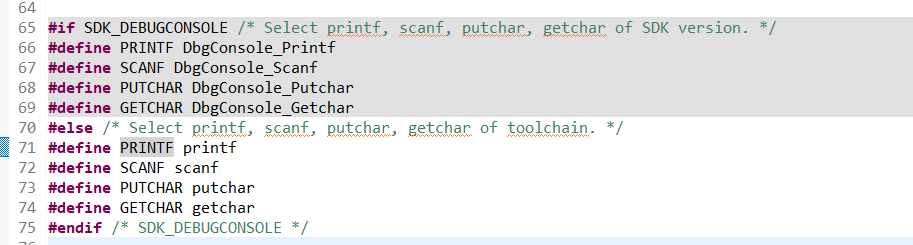

i have met a issue when using semihost console mode, the demo can not pass the compilation.
the details as below:
Demo code :
   frdmkw36_wireless_examples_bluetooth_glucose_s_freertos
settings for printf:
   checked or unchecked “Redirect SDK “PRINTF” to C library “printf” , both have tried while importing the demo
Setting for  SDK_DEBUGCONSOLE:
Code changed:
   ported the BOARD_InitDebugConsole related code from hello work demo
Results:
1) Set to Semihost cosole mode, the demo cannot pass the compilation while PRINTF is called.
the error test is :  C:\Users\DELL\Documents\MCUXpressoIDE_11.0.0_2516\workspace\frdmkw36_wireless_examples_bluetooth_glucose_s_freertos\Debug/../source/glucose_sensor.c:241: undefined reference to `_printf'
thePRINTF is called here:
on this condition, no matter the setting of “printf ” lib
2) Setting to uart console mode
the compilation is ok, and the uart terminator is printed the expected strings.
summarize: if the  SDK_DEBUGCONSOLE = 0,
the printf and related fucntions should defined from the IDE lib, should not have this compilation error.
But why this happen?

The wireless connectivity examples need the debug console set as a UART as the stacks has some timing requirements that are not met when using the semihosting as well as the resources used in order to achieve it.
Sorry for the inconveniences this might cause you.
