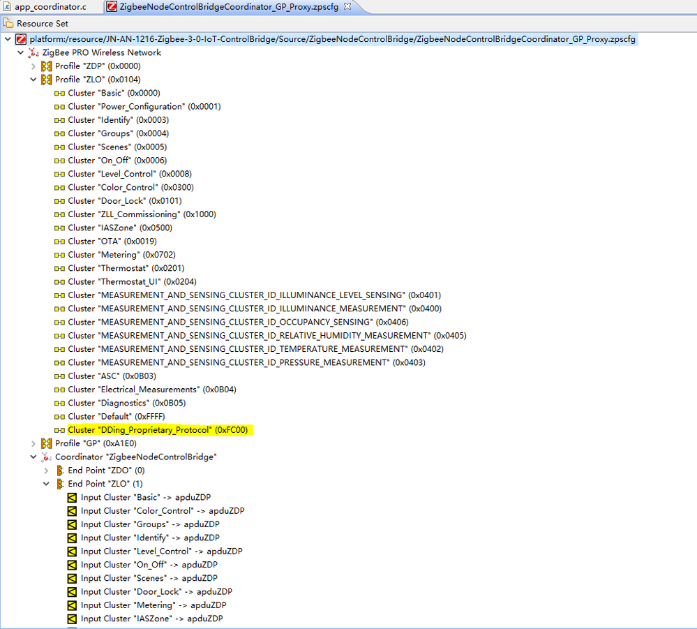

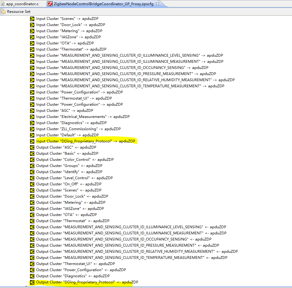

     I want to add a custom cluster(0xFC00) to SDK(JN-AN-1216-ZigBee-3-0-IoT-ControlBridge),and I have edit the ZigbeeNodeControlBridgeCoordinator_GP_Proxy.zpscfg file as below:
I want the 0xFC00 cluster support server and client,and some commands and attributes

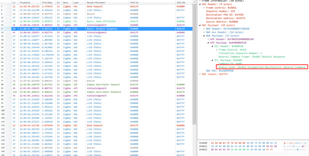

I have add 0xFC00 Cluster to the 4170 SDK, and simple description response show it already support both client and server with 0xFC00 cluster,but when I read other attributes like manufacture name,it would‘t return "read attribute response",but it return the default response with status(0x84)微信图片_20180917130042.png微信图片_20180917130054.png
