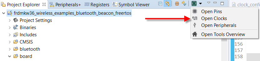

Select your proyect on MCUXpresso IDE, then open the clocks configuration window from Config Tools by clicking the arrow next to Config Tools icon from your MCUXpresso IDE, and then select "Open Clocks" as shown in Figure 1.
Figure 1. Open Clocks from Config Tools using MCUXpresso IDE.

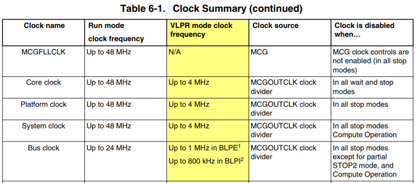

Figure 3 taken from KW36 Reference Manual shows achievables frequencies when MCU is on VLPR.
Figure 3. VLPR clocks.

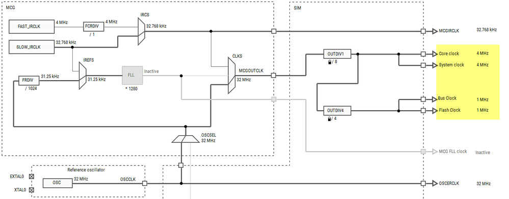

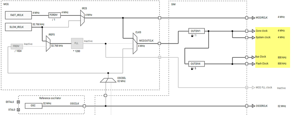

Core clock should be 4MHz for BLPE and BLPI clocking modes, and Bus clock should be 1MHz for BLPE and 800kHz for BLPI.
Figure 4 shows clocks distribution for BLPE and Figure 5 for BLPI to operate with discussed frequencies.
Figure 4. Clock distribution - VLPR and BLPE.
Figure 5. Clock distribution - VLPR and BLPI.

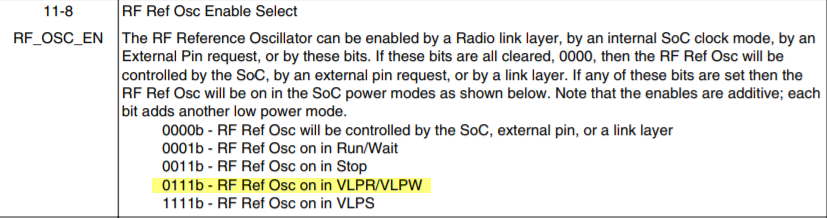

1. Configure RF Ref Oscillator to operate in VLPR mode.
By default, the RF Ref Osc it's configured to operate into RUN mode. To change it to operate on VLPR mode just change the bits RF_OSC_EN from Radio System Control from 1 (RUN) to 7 (VLPR). Figure 8 taken from KW36 Reference Manual shows RF_OSC_EN value options from Radio System Control.
Figure 8. RF_OSC_EN bits from Radio System Control register.
Go to clock_config.c file in your MCUXpresso project and search for "BOARD_RfOscInit" function. Change the code line as shown in Figure 9 to configure RF Ref Osc to work into VLPR mode. You may see a window asking if you want to make writable the read-only file, click Yes.

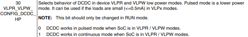

2. Configure DCDC in continuous mode.
According to KW36 Reference Manual, the use of BLPE in VLPR mode is only feasible when the DCDC is configured for continuous mode.

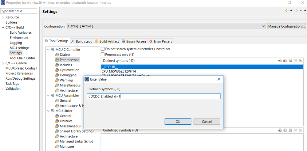

First, let's define gDCDC_Enabled_d flag to 1 on preprocesor. With this implementation, the use of DCDC_Init function will be enabled, and it's where we going to add the code line to enable continuous mode.
Right click on your project, select Properties, go to Settings under C/C++ Build, then Preprocessor under MCU C Compiler (Figure 10).
Figure 10. MCUXpresso Preprocessor
Click on add button from Defined symbols, write gDCDC_Enabled_d=1 and click OK to finish (Figure 11).
Re-compile your project.
Figure 11. MCUXpresso Defined symbols

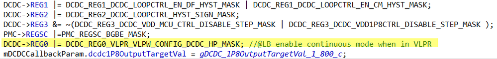

Now let's set VLPR_VLPW_CONFIG_DCDC_HP bits to 1 from DCDC_REG0 register. Figure 12 was taken from KW36 Reference Manual.
Figure 12. VLPR_VLPW_CONFIG_DCDC_HP values.
Go to DCDC_Init  function and add the next code line to enable continuous mode on DCDC:
  • DCDC->REG0 |= DCDC_REG0_VLPR_VLPW_CONFIG_DCDC_HP_MASK;
Figure 13 shows the previous code line implemented in firmware project inside of DCDC_Init function.

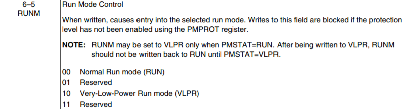

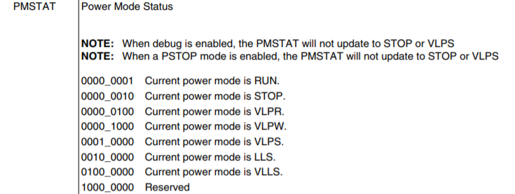

The code is configuring MCU into VLPR mode with bits RUNM from SMC_PMCTRL register (Figure 14) and then check if it was correctly configured by reading status bits PMSTAT from SMC_PMSTAT register (Figure 15)
runm.pngFigure 14. RUNM bits from SMC_PMCTRL register.
Figure 15. PMSTAT bits from  SMC_PMSTAT register.
