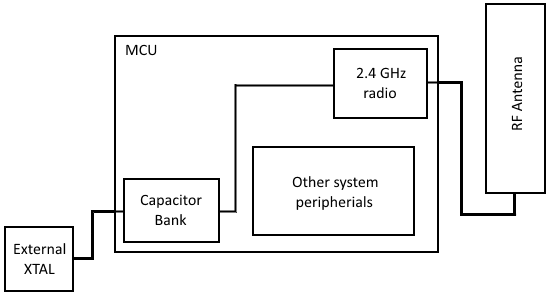

In the Kinetis W series, for example, the XTAL used for wireless operation is usually the oscillator also used as a core clock. Now, while this external oscillator is connected to the MCU, it is also connected to an internal programmable capacitor bank. What is the purpose of these capacitor banks? To allow frequency trimming.
And why would you want to trim the frequency provided by this oscillator? Well, to properly adjust the central frequency to where it should be operating. This option exists because not every design is going to be the same: not the same PCB, not the same components, not the same manufacturing process. Thus, having the option to adjust the frequency provided by the external oscillator allows to any possible device to operate under the same conditions is essential.

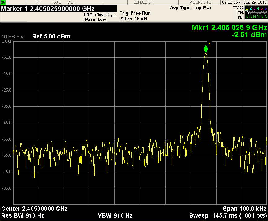

Let’s say your design is using a 32 MHz external oscillator, but because of the conditions of your whole design, the operating frequency ends up being slightly different. Now, if this design transmits over the air through 802.15.4, there could be some consequences to this slight shift in frequency. This capture shows a transmission made without being centered in the desired channel.
This signal should be centered exactly on 2405 MHz, as specified by IEEE 802.15.4 channel 11.
As you may see, in this case the frequency is actually centered on 2405.0259 MHz.

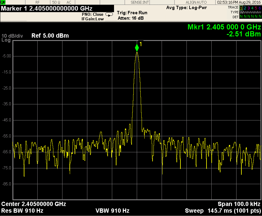

Trimming these capacitors to change the frequency obtained from the oscillator can help to adjust error. In this case, the frequency was adjusted so that it was centered in the central frequency of the desired channel, to prevent any possible mistakes while transmitting to other devices.
Once the XTAL is trimmed, the signal is effectively centered on 802.15.4 channel 11's frequency, 2405 MHz.
