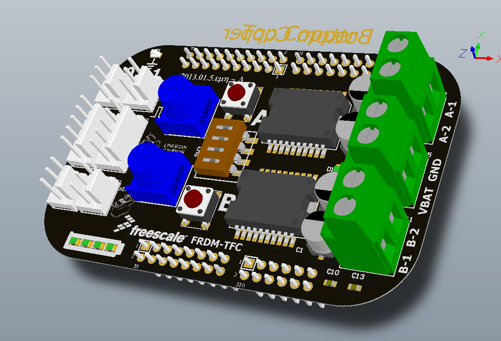

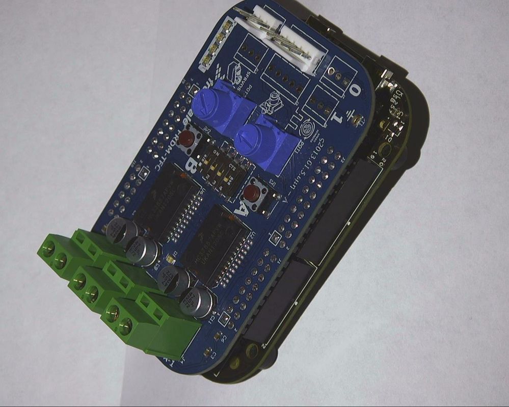

Overview
The FRDM-TFC is a convenient "shield" that can drive up to two DC motors (5A per channel), two servos and I/O for the Freescale cup line scan camera and Hall effect sensors.  This board mates with the KL25Z Freedom board for primary usage with a Freescale Cup car.
Features:
  • 2 channel Motor Driver ICs (MC33887APVW)
  • 2 channel servo Outputs
  • Dual Linescan Camera interfaces
  • Two inputs for speed sensors
  • Two potentiometers for user functions
  • Two push buttons for user functions
  • 4 Position DIP Switch for user function
  • 4 LEDs (green) for battery indicator or user functions

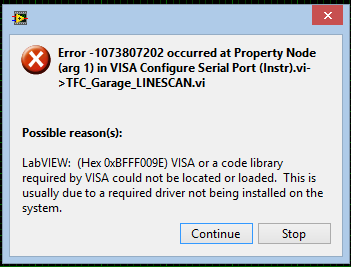

I have a problem trying to run the labview application for the line scan camera. I got the following error:
Can someone help me?
Dear Andres,
Do you have installed the NI VISA drivers from National Instrument Website?
Here is the link:
NI-VISA 5.4 - National Instruments
Hi Juan,
Thanks for your help. I have to install the drivers before or after install Labview?
Best,
Dear Andres,
1.- First install the LabVIEW.
2- Then install the NI Device drivers: NI Device Drivers 2013.02 - National Instruments
3.- Finally install the NI VISA drivers: NI-VISA 5.4 - National Instruments
-Juan
