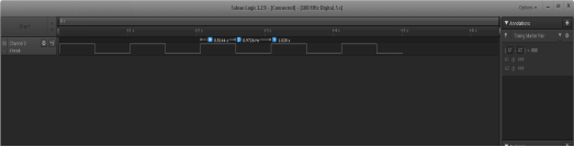

Diego,
Thanks for the reply.  No, I don't expect the FIFO to fill in 2.5 ms.  I expect (if my sample rate is set to 400 Hz) to pull 400 samples from the FIFO in approximately 1 second.  The results I'm getting have me pulling 400 samples from the FIFO every half a second.  My assumption was that, with the FIFO enabled, those data points that are available at the output every 2.5 ms are instead put into the FIFO at that rate.  And so can be pulled from the FIFO at approximately that same rate as well.  Am I wrong?
My main loop structure is as follows:
1) Check the accelerometer to see if the FIFO is full.
   1a) if it is, pull all the data from the accelerometer FIFO into my own local FIFO.
2) If there's data in my local FIFO, process it, one sample at a time
   2a) For each sample processed, increment a sample counter
3) If my sample counter reaches 400, flip the state of an output pin and reset my sample counter
4) Restart loop
I've attached a screenshot from Logic capturing the state of that output pin:
As you can see, the state of the pin changes approximately every 500 ms, meaning I'm processing 400 samples in that time, meaning the accelerometer is outputting data at approximately 800 Hz.
I'm fairly confident of my settings (posted above), the relevant one being my setting for Control Register 1 (0x0B - Fast Read, 400 Hz ODR, Enable chip), but there may be something I'm missing.
Any further help would be highly appreciated.
Sam
