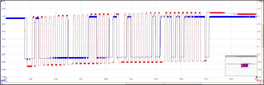

benjaminbush
Hey Tomas,
        Your code will only read data when it says there is new data is available, which is not the problem I'm talking about. My code returns DR_STATUS first and then I can check it if the data is new (register 0x00 goes to DR_STATUS unless configured differently, which I have not done). The issue is that there is never any new data after a couple minutes of operation. As in my code works (I get gyroscope data) until something happens and no new data is acquired. I retried it today, and once again communication if fine, but no new data gets generated. Why does no new data get generated when it used to work? I've attached the waveform for the following command
FXASReadByte(FXAS21002_WHOAMI, recvdata+1);

TomasVaverka
Hi Benjamin,
Sorry for our late response.
Does the problem still persist? If so, please share here or send me your complete source code. It might be also helpful to see what is going on on the bus if you have a logic analyzer or an oscilloscope.
Tomas

TomasVaverka
Hi Benjamin,
It is hard to debug your communication routines, it would be much easier using a logic analyzer or an oscilloscope.
However, looking at your main() function, the way you are trying to get the data is not correct. Basically there are two possibilities to read the current XYZ data. First is using the INTx pin for an interrupt when a new data is ready and the second option is reading the ZYXDR bit in the DR_STATUS register (0x07). Actually this polling technique requires less configuration of the device and is very simple to implement.
So basically the code might be like this:
for (;;)
            DR_STATUS = IIC_RegRead(0x07);
            if (DR_STATUS & 0x08)
                        IIC_RegsRead(0x01, 6, GyroData);                    // Read data output registers 0x01-0x06
            // Perform other necessary operations
Hope it helps!
Tomas
