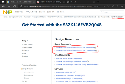

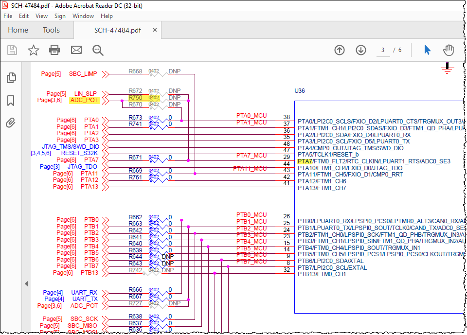

I am using #S32K116 Eval Board - S32K116EVB2Q048.
The board has one ADC_POT, but it looks there is no connection. Can you help me if I am looking at the correct schematic. And if so, how to observe the change in POT values when programming on S32K.

Can you correct the schematic for the same in the Get Started with the S32K116EVB2Q048 | NXP Semiconductors.
Currently I see the schematic for S32K144EVB as seen below -

1. Looks like the schematic has been updated to S32K116. But it looks like the schematic is for different version. EVB vs EVB2. Please verify for the same.
2. Is it possible to get the BOM for the EVB board ?

For S32K116EVB2Q048, SCH-47484.pdf is correct schematic. The latest S32K1xx SDK select PTA7 (ADC0_SE3) sample the Potentiometer. But the R750 is DNP, you need to solder it by your self..
