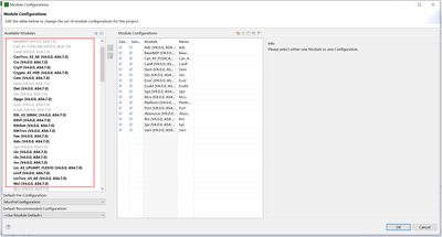

HI,
I installed a package of RTD4.0.0
But I did not find the Fls module when I selected the module in EB

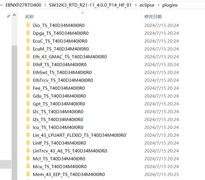

There is also no folder for Fls under the RTD4.0.0 installation path
What I want to know is that the RTD4.0.0 package itself does not support Fls module?
What do I need to do if I want to use the Fls module in this package of RTD4.0.0?
(The reason I use the package RTD4.0.0 is that it supports the FS26 module)

Hi @xuan,
The package you are using is ASR 21-11 (4.7) compliant. There have been some changes from ASR 4.4 to 4.7 (21-11). Here is a community post explaining the changes made: Solved: no fee and fls modules in RTD of s32k3x - NXP Community.
You can use the new modules (MemAcc, etc.) instead, or you can also download an ASR 4.4 version for the RTD package instead.
Julián
