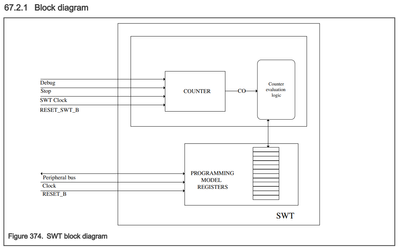

Looking at the title and from your question, we assume you are asking the following:
"Does the S32K3 series microcontrollers have watchdog hardware timers or watchdog software timers?"
If so, as you are implying, it is a naming convention. Since the SWT has registers that need configurations, it is a module embedded inside the MCU itself that requires an initialization [Page 2749, Chapter 67.5, S32K3xx Reference Manual, Rev. 6, 04/2023]. This can also be seen under the SWT Block Diagram [Page 2747, S32K3xx Reference Manual, Rev. 6, 04/2023]:
Please, let us know.
