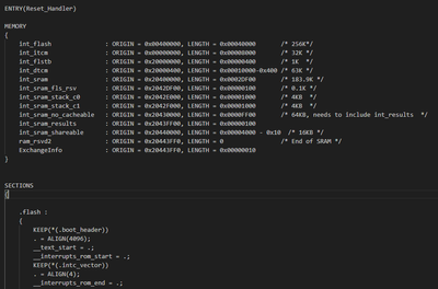

I am developing bootloader. But I have difficult in jumping(bootloader to application),
So I am testing jump routine to bootloader from Bootloader like below.
But I got the error like picture 1.
Could you recommend some debugging point?
Thank in advance.
picture 1)
picture 2)
picture 3) code
picture 4) loader file

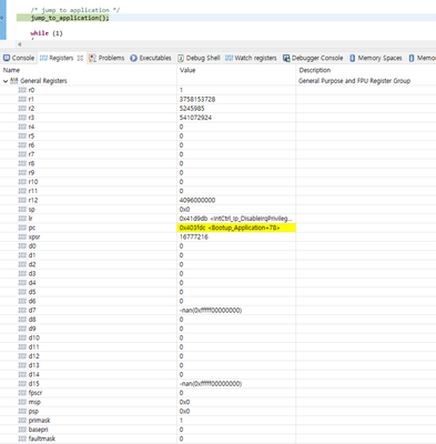

Changhawn
Dear danielmartynek.
When I try todo with your guide, still have problem like below picture 1).
picture 2) is register view before running application_reset_handler
I will check and search this problem in Community. If you give some guide, thank you very much.
picture 1)
picture 2)
