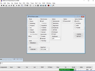

I debug flash driver, and get a exception. After that the Trace 32 shows bus error, and can't reprogramm.
How to recover it?

Does this happen during the Startup, during the run time of the application or during a flash operation?
I would recommend implementing the HardFault_Handler() in the project, and debug it as it is shown here:
https://community.nxp.com/t5/S32K-Knowledge-Base/Fault-handling-on-S32K14x/ta-p/1114447
What kind of bus fault is it?
If a precise fault, what is the content of the BFAR register?
