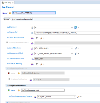

I'm facing an issue when configure the ICU on tresos tool. Basically I need PWM and ICU in my project, PWM is working properly, but when I configure ICU, I get error:
This is the configuration:
ICU:

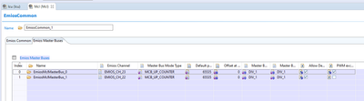

MCL:
I have other emios channels configured because I'm using PWM:
But the error appear only when I enable the ICU module, if I disable, I don't get this error:
Version used: S32K3_S32M27x Real-Time Drivers ASR R21-11 Version 5.0.0
Can anyone help me with this problem, please? I appreciate it!

Hello @_Leo_ ,
I could find ICU example for Tresos, but I replicate it and it didn't work.
