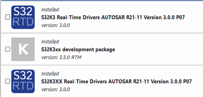

I have a MR-CANHUBK344 development board, which I am debugging using a J-Link base v11.0. The J-Link has the latest firmware, and I'm using the latest J-Flash tools/drivers for ARM64. I'm running S32DS in a virtual windows machine on MacOS, and everything has been working OK with that. I've been able to attach to the target and flash code. I'm using S32DS 3.5 and RTD 3.0.0-P07

S32DS packages:
