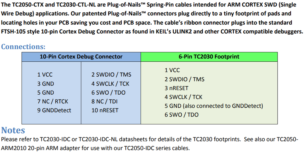

I know this is an old thread but I can't find where the SDA_RST pin goes to the MCU on the EVB schematic.  It goes to the barRESET pin on the K20.  Am I wrong that the reset isn't necessary for programming an external MCU?
I would like to use a 6 pin header for programming my board.  Tag Connect shows a specific cable with JTAG pinout that has RESET on there but not JTAG_TDO.  If I'm wanting to program and debug using the S32K144EVB as my programmer, can I use the proposed pinout from Tag Connect or should I move to a 10pin programming header?
