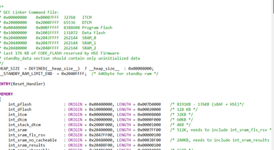

I am unable to configure the S32K358 stack size. Below is the linked id file. It is same for any S32K358 RTD example file for me. I need to increaze my stack size, how do I do it?

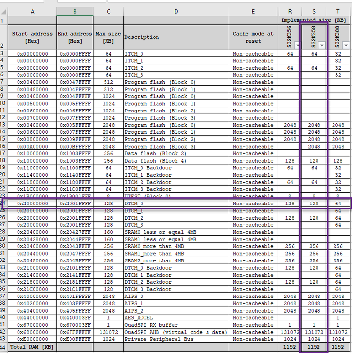

There is 128KB of DTCM0 on S32K358.
You can increase the size of int_stack_dtcm (LENGTH) from 4KB in the linker file.

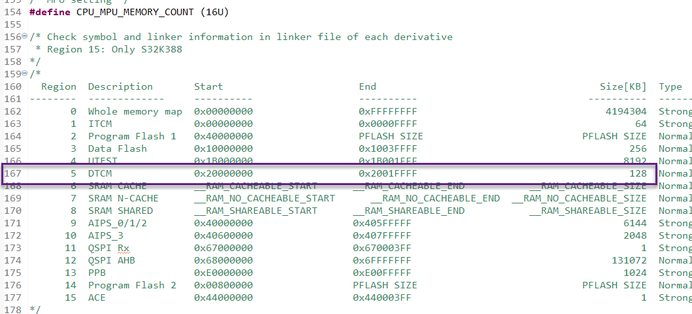

I see that the MPU configuration in system.c already works with the whole DTCM0
