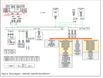

Hi There,
Referring Figure8 Block Diagram page 24 Reference manual:
It seems that CM7_1 accesses to bus via MDAC4, when XRDC is enabled. So in Lockstep mode i have to manage only MDAC0 (CM7_0)?
