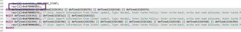

I have any decoupled S32K344 (S32K314).
HardFault error happens SystemInit runs after the firmware is installed
MCAL version : SW32K3_RTD_4.4_R21-11_3.0.0_P01_HF02
Please find the attached file

Hi @HyunungPark1,
Seems like there is missing S32K314 macro for the MPU descriptor 2 in this 3.0.0 P01 revision.
