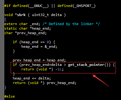

if I create a FreeRTOS task by xTaskCreate()/xTaskCreateStatic(),, and call malloc() to allocate some memory in the task context, the malloc() return NULL.

after some debugging, I firgured out that this is caused by the sbrk() implementation in S32DS/e200_ewl2/EWL_C/src/stdlib/alloc.c.
sbrk compare the heap pointer with the stack pointer, but in FreeRTOS task, the stack is always located before heap.

so sbrk failed at this compare and return -1.

thanks, implement a own sbrk(remove the stack pointer checking) to replace the one in EWL libc fixed my issue.
but does NXP have plan to fix it in Beta SDK version ? anyway it is a bug in EWL lib I think.
/WX
