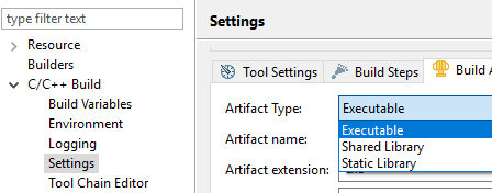

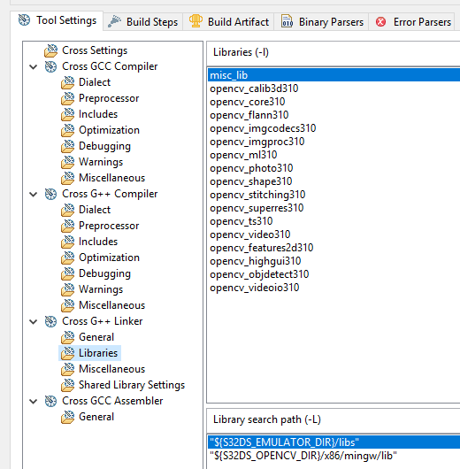

Hi Byungju,
This is done in the same way as for any Eclipse CDT based IDE.
You can create Library project from Wizard or change the Artifact type in the project settings:
The library can be added in the Linker settings. You should set library name and path, for example:

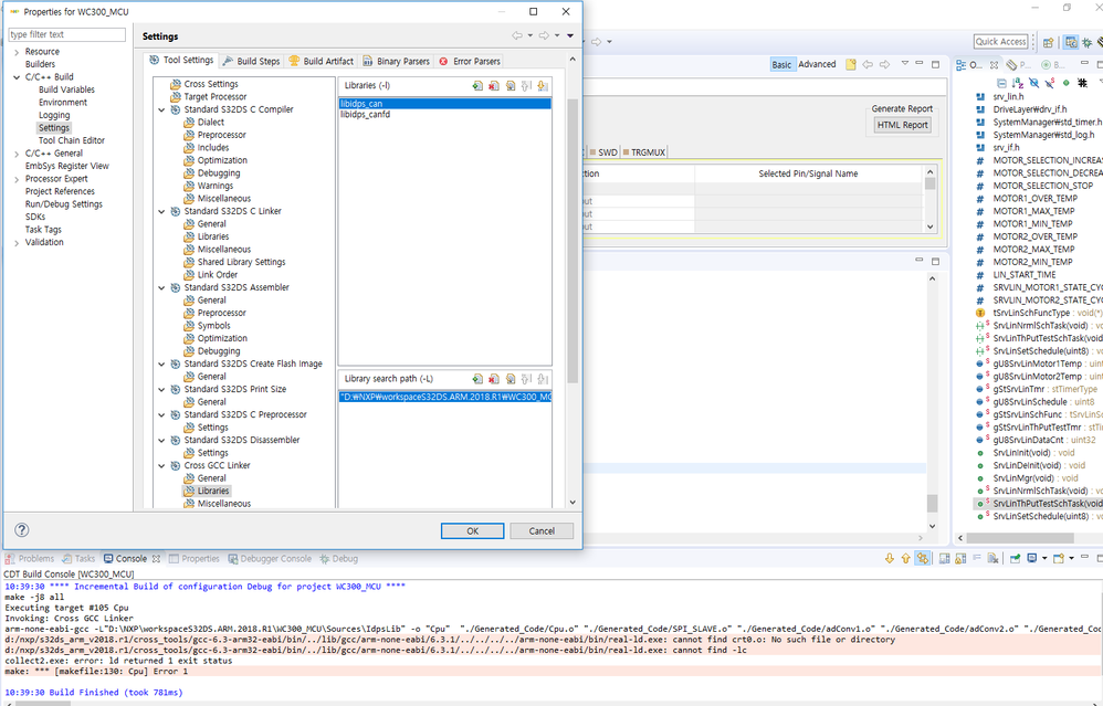

kbj
Dear Dmitry,
Thanks for your response.
I add library following your answer.
But Copile error is occured.
How can I resolve it?
Please let me know.
Thanks and best regards,
Byungju.

b48014
Hi Byungju,
1. Looks like you have  error with libc. Could you show me your Target Processor settings?
Please double check Libraries support field.
2. Please delete prefix lib from library name. From the gcc documentation:
-l library ...
... surrounds library with lib and .a and searches several directories.
Dmitry

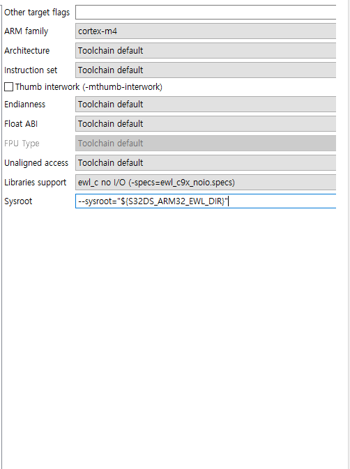

kbj
Dear Dmitry,
My target processor setting is like below.
best regards,

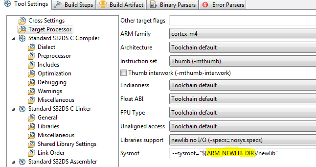

b48014
Hi Byungju,
Could you try to select "newlib no I/O" instead of "ewl no I/O".
You can also send me your projects (application and library) to test.
Dmitry

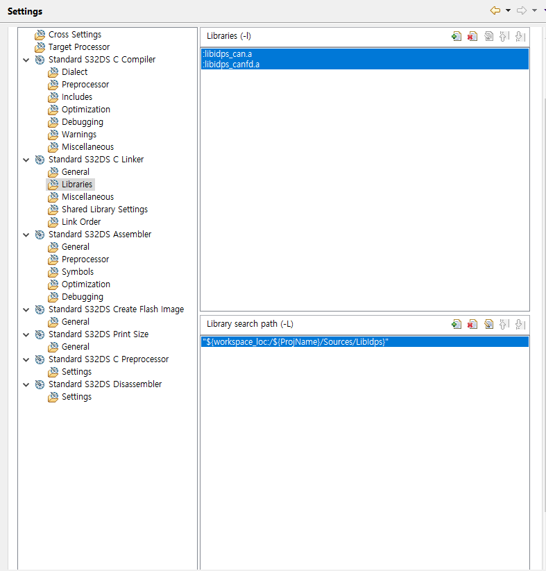

kbj
Dear Dmirty,
I resolve it by using another way.
I input library name like below.
Byungju.
