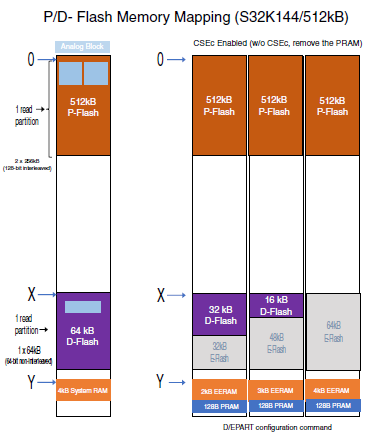

From Data spec of S32K144, I only understand there is 512 KB of flash and 64 KB of system RAM.
But from one of reference manual of S32K144, I got below screenshot which I am not able to interpret. Can you please provide more information if you can please ?
Referring to below screenshot, I know PRAM is of 128 Bytes.
Mohan

Hello Mohan,
Please find below an explanation for each of the functions mentioned by you.
initFlashForCsecOperation(void):
  • checks if the Flash was partitioned for CSEc operation;
  • if not, partition the Flash and select the number of user keys - FLASH_DRV_DEFlashPartition(&flashSSDConfig, 0x2, 0x4, 0x3, false, true);
         - the 0x3 parameter specifies that there will be 24 available user keys; for more details, please see the documentation of the FLASH_DRV_DEFlashPartition function.
