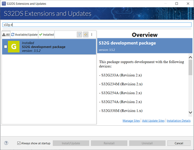

mikedoidge
Hello @MichalMatyl,
The S32 Flash Tool includes S32V234 and S32S247TV with the base install, for additional devices support, you are required to install the respective S32DS Development Package.
In the case of S32G, this would be 'S32G development package', latest version for S32DS 3.5 is version 3.5.2.
Mike

MichalMatyl
Yes, exactly. Thank you for pointing this.
This is where the confusion comes from, most likely I haven't completed S32DS installation process. The basic package, which is Windows installer, is only "bare" S32DS installation. One need to install this additional "S32G development package" from S32DS itself.
After that I could finally see 4 additional targets in the FlashTool, including "S32G2xxx". But this is where things only start getting interesting. Because I can "talk to" the chip - test connection, upload target and get flash ID but device download yields only zeros.
