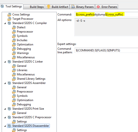

I am using MPC5744P for development, and I would like to use the disassembly while debugging.
Problem is that I am having unknown instructions in the disassembly: pastedImage_1.png
It seems it is expecting power instructions, while the actual ones are powerPC. I use powerpc-eabivle-objdump.exe from console to disassemble the code manually, and it works great, but I would like to have it integrated in the S32.

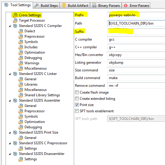

Going through settings I tried to set the path to the right objdump executable, but according to settings it seems the right executable is already used. Eclipse variables might be different than expected and I don't know if I can check how they look like.
According to the project settings in these pictures:

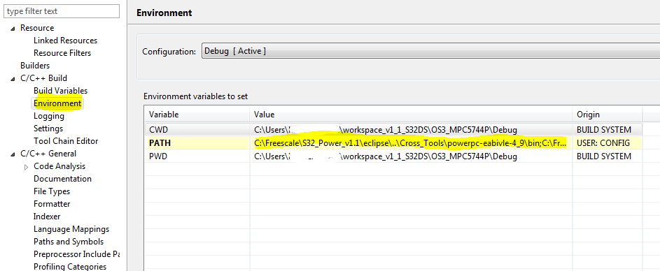

This configuration should call powerpc-eabivle-objdump which is unique executable in the whole freescale folder, and I checked that the folder containing the executable is included in the environment PATH variable:
Any ideas?

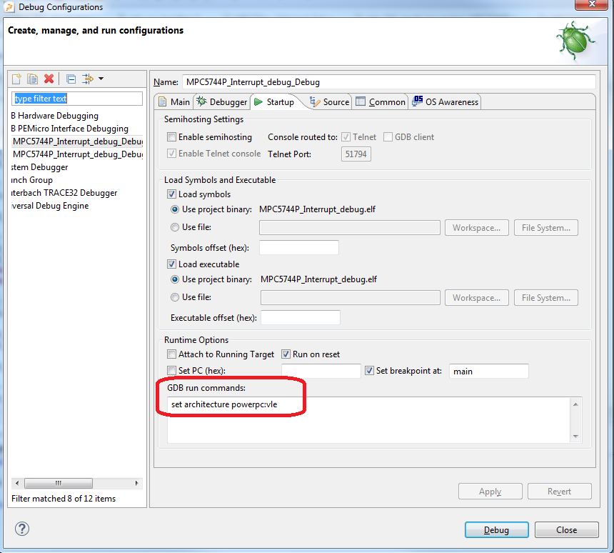

You probably refer to the Disassembly View visible during a debug session.
Could you check if your debug configuration includes "set architecture powerpc:vle" in GDB run commands box?
This should switch the debugger into VLE mode.

Yes, I referred to the Disassembly View.
Adding the option did the trick,
Thank you
