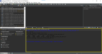

My customer wants to export the contents of the console window in S32 Design Studio, is it possible to do this? The customer wants to do this because in his project, the compiling information can't be completely displayed in the console window:

build console has limited number of rows. This can be changed in the main menu bar -> Windows -> Preferences -> C/C++ -> Build -> Console:
