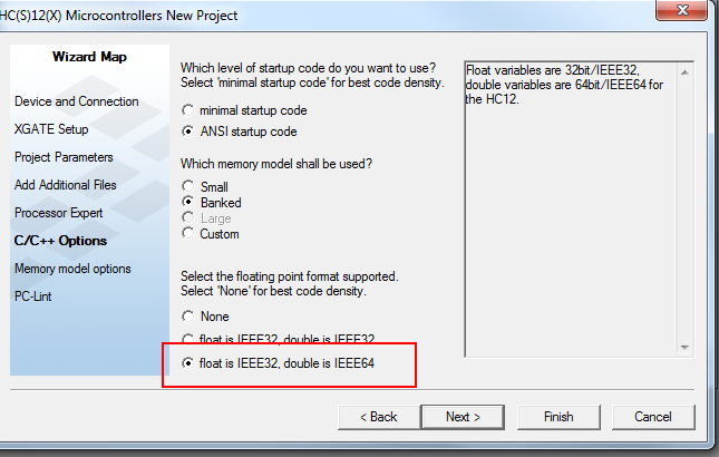

The customers is using CodeWarrior Development Studio for HCS12(X) Microcontrollers (Classic IDE) v5.1 do a S12 project,Which need use 64 bit integer operations. The results is correct when set unsigned long 32 bits, But if set to unsigned longlong 64 bits , the result is error. How can we set up a 64 - bit integer? thanks!

When you create project , please try configure :

I've tried this, but it's floating point type, and use an integer that needs to change.

Sorry  i said before is wrong .
the HCS12(x) chips is 16 bit , so the maximum bit is 32 , it can not  realize 64 bits.
For the kinetis chip , for it is 32 bit , so the longlong type is 64 bits.

It's not true that 16bit MCU can't have 64bit integers in C. Even 8bit MCU's can do. But CW for S12(X) doesn't support it.
