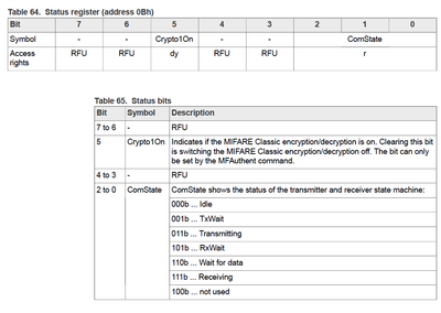

After reading version register of the RFID Chip we are understand this is MFRC63002 chip as per data sheet, also we have read Mifare 1K classic card.
After trying authentication say after 2-3 min MFRC630 doesn't detect any card, we can say it gets stuck, hence need to restart.

Hi  Santosh P
If the device gets stuck, I would suggest you dump the status register to check the reason.
