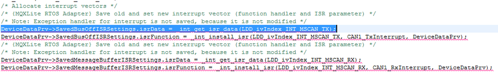

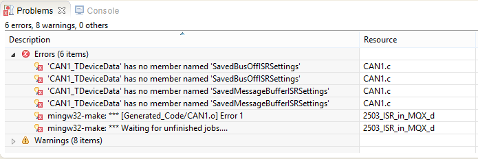

I have used KE06Z, and with MQX Lite, while I used CAN_LDD with interrupt service active there are several errors as below:
and I verified structure CAN1_TDeviceData, and there is no member called 'SavedBusOffISRSettings', and I have tried deleted these lines and compile passed, but cannot go into ISR.
these codes are in 'LDD_TDeviceData* CAN1_Init(LDD_TUserData *UserDataPtr)'

marek_neuzil
I have tried to reproduce the error in CW MCU 10.6.3 and KDS 2.0.0 but the generated code can be compiled without any error. I have also checked that the CAN_LDD driver contain the same code you have mentioned:
  /* Allocate interrupt vectors */
  /* {MQXLite RTOS Adapter} Save old and set new interrupt vector (function handler and ISR parameter) */
  /* Note: Exception handler for interrupt is not saved, because it is not modified */
  DeviceDataPrv->SavedBusOffISRSettings.isrData = _int_get_isr_data(LDD_ivIndex_INT_MSCAN_TX);
But this code can be compiled without errors.
Could you send me the project or the Processor Expert project configuration (Exported Component Settings - .peb file)  for analysis, please?
Please, send me also the version of the Processor Expert product you are using (e.g. CW MCU 10.6.3, KDS 2.0.0).

Thanks for your intention, but i have already solve the problem, by adding
two elements into LDD CAN structure in can.h.
https://github.com/HanchengYANG/ProcessorExpertCAN_LDD_BUG_FIX/blob/master/Readme.txt

marek_neuzil
Hello Carlos,
The issue has been fixed in the KDS 3.0.0 (PEx for Kinetis 3.0.0). You can see the issue PEXMCU-1276 in the Revision History of the KDS_3.0.0\eclipse\ProcessorExpert\PEx_for_Kinetis_3.0.0_Release_Notes.pdf:
PEXMCU-1276 - Fixed defect: The CAN_LDD component code doesn’t build when using with MQX-Lite. The structure <Name>_TDeviceData in the CAN_LDD header file is missing members, like SavedBusOffISRSettings.
