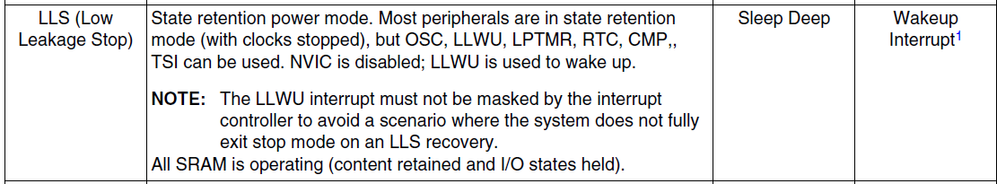

I have checked your wake-up conditions and actions and I have only following comments:
case #3 - the GPIO interrupt handler may not be invoked when LLWU wake-up the CPU. The GPIO is in static mode in the LLS. In addition, the GPIO (PORT module) interrupt condition can be set differently than LLWU condition for the same pin. See also the description of the LLS mode:
case #4: The LLWU interrupt will be called when the wakeup interrupt is detected. It is the same case as number 3.

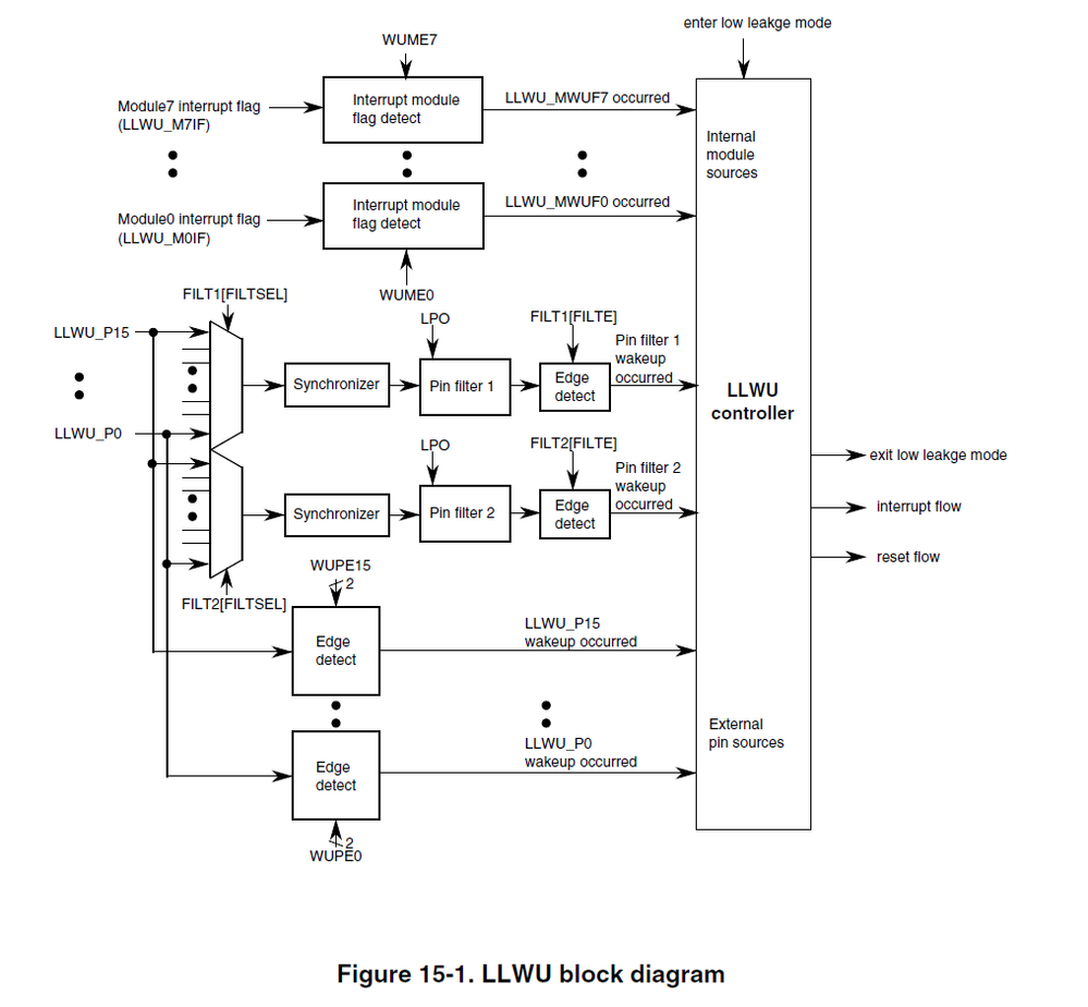

I am not sure what is not clear about exit of the LLS mode by using LLWU but I recommend to read the reference manual for the KL25Z derivative - Chapter 15 Low-Leakage Wakeup Unit (LLWU). There is detailed description how the LLWU works on KL25Z.
See for example the block diagram and the LLWU features description:
The LLWU module features include:
• Support for up to 16 external input pins and up to 8 internal modules with individual
enable bits
• Input sources may be external pins or from internal peripherals capable of running in
LLS or VLLS. See the chip configuration information for wakeup input sources for
this device.
• External pin wakeup inputs, each of which is programmable as falling-edge, risingedge,
or any change
• Wakeup inputs that are activated if enabled after MCU enters a low-leakage power
mode
• Optional digital filters provided to qualify an external pin detect. When entering
VLLS0, the filters are disabled and bypassed.
Marek Neuzil
