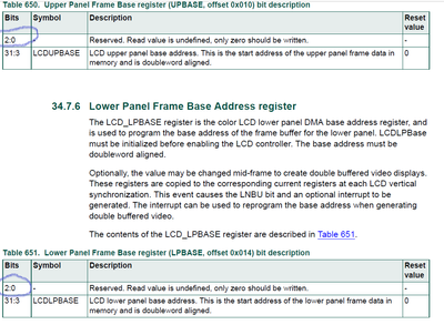

Another Question is, what does this assertion from the driver "fsl_lcdc.c" really mean:
+"assert((config->upperPanelAddr & 0x07U) == 0U);"
+"assert((config->lowerPanelAddr & 0x07U) == 0U);"
Is it bad if i let those commented? Because i have commented this so that i can use the qca_demo (VCOM port) to create a UDP connection. Right now my project is a cross between qca_demo and lcdc_cursor. Right now it is working.

Pls refer to the LCD frame buffer register definition, the low three address bits must be zero.
Hope it can help you

For the following two lines in fsl_lcdc.c, they are only valid in compiling stage, I think they can be removed, but you have to make sure that the low three bits of variable config->upperPanelAddr are zero.
Xiangjun Rong

Thank you first of all for the help, i realised there might be something more about the upperPannelAddress, if i use the defined value:
static uint8_t s_frameBufs[IMG_HEIGHT][IMG_WIDTH / APP_PIXEL_PER_BYTE];
[My calculated value of s_frameBufs is 536876580 [DEC] and 100000000000000001011000100100 [BIN], but here aren't the low three bits zero]
You can see the result in the first picture. It looks like some pixel dont print right, but that only because of the handy photo. Here the screen is printing everything fine.
When I change the value of upperPannelAddress to (uint32_t) 0 or just 0. The screen hasn't filled the screen properly. (See the second picture).
Does it have a big impact if i let the value not Zero?
Dilsan M.
