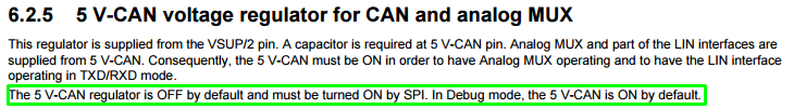

I use the CAN send function, i check there is signal on can_tx pin of KEA64, while there
is no signal on CANH and CANL on MCZ33903CD5EK chip.
So i doubt whether there is a bit that need enable by manual ?
Or there is a CAN demo used on FRDM-KEA64 board ?
Thanks!
Hello!
I have same issue. Can you tell me how u resolve this?
Hello Fan,
It is necessary to turn-on the 5V-CAN regulator unless the device is in Debug mode (8V-10V at the DBG pin - TP26):
This is done using 5V-can[1:0] bits:

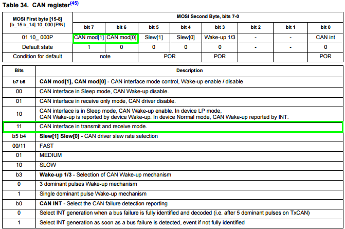

Then you have to also set both CAN mod[1:0] bits:
I guess in CW10.7 there is CAN example code for FRDM-KEA64 board.
