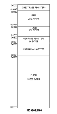

The JM60 does not have paged memory.

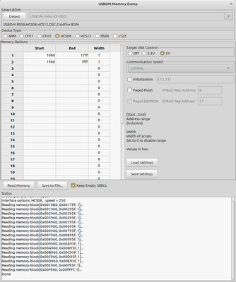

The following worked for me (under Linux):
Post details of the hardware and software version and OS if you are having problems.
Updated to show using JM60 based USBDM reading the JM60 chip.

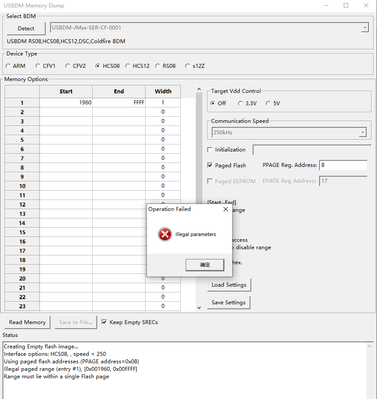

What was wrong with my operation?

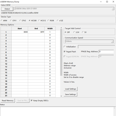

how to use USBDM Memory Dump?
Those parameters need to be filled in, and those do not need to be filled in. How many parameters should be filled in?
