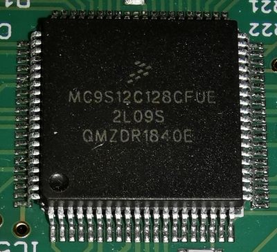

One question - Are you sure the chip is a MC9S12C128 and not a smaller chip?

ProNet36
hi there,
yes, i'm absolutly sure.
attached you will find a Picture.

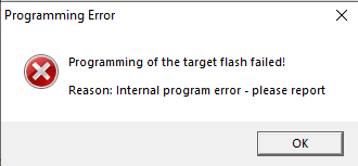

What else I noticed, with the version
USBDM_4_12_1_262_Win.msi
programming is not possible and there is always this error message:
read out and delete work, but write is absolutly not possible.

Exactly I have a board where I tried to pull a dump from the processor to play it on another board.
I also have a PE Micro Cylone Pro and the original flash file.
However, the HCS12 programmer cannot do anything with the address range.

ProNet36
attached the result with the version 4.12.1.240
it's the same problem. I have try too many older versions...
All have the same problem.
i have also bought 2 BDM programmers like this more.
https://www.amazon.de/gp/product/B07KSD2SFF/ref=ppx_yo_dt_b_asin_title_o02_s00?ie=UTF8&psc=1
All 3pcs. have the same problem.
bye
