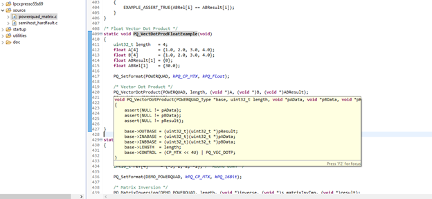

Built into the SDK for the LPC55S69 are plenty of PowerQuad examples.   “powerquad_matrix” has plenty of examples that exercise the PowerQuad matrix engine.
Figure 6:  PowerQuad Matrix Examples in the SDK.
Let us take a quick peek at the vector dot product example:
Figure 7:  PowerQuad Vector Dot Product.
As you can see, there is actually very little required setup PowerQuad  for a matrix/vector computation.      There are handful of registers over the AHB bus that need configured and then the PowerQuad will do the work.  I hope this article got you thinking of some neat applications with the LPC55S69 and the PowerQuad.       Next time we are going to wrap up the PowerQuad articles with a neat application demonstration.   After that we are going to look at some interesting graphics and IOT applications with the LPC55S69.  Stay tuned!
