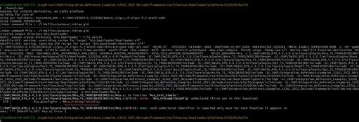

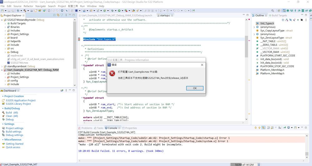

Hi John,
We want to open ivt tool but met some troubles:
Does it look like software version mismatch?

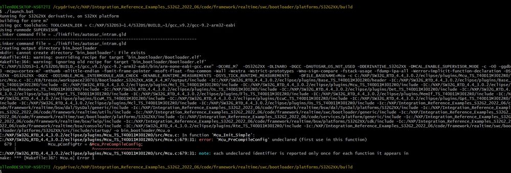

Another trouble is build failed:
May I lose some steps?
Thanks.
Allen
Update my issue state:
Modify as following, use EB to build can success but boot failed. No console output.
- bootloader >> MCU >> MCU >> General >> Config Variant => VariantPreCompile
Bootloader >> SysDal >> SysDal >> General >> SysDalGeneral 的 Enable MCU from sysdal = unchecked
Hi John,
Did you meet the build error?
Thanks.
