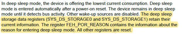

Hello community,
If MC33774 suddenly loses power, which registers will retain the information before the power outage? I didn't find relevant content in the Datasheet. Could you help me? Thank you.

Hello Yang,
When VBATUV is detected, POR is generated and then the MC33774A enters the deep sleep mode.
BR, Tomas
