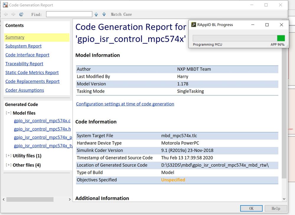

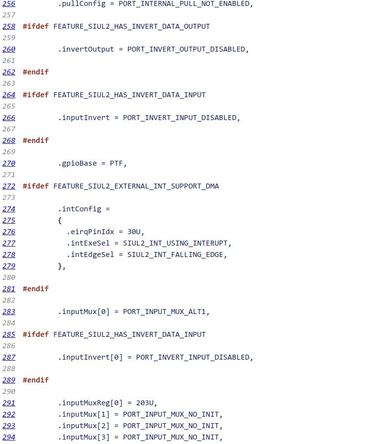

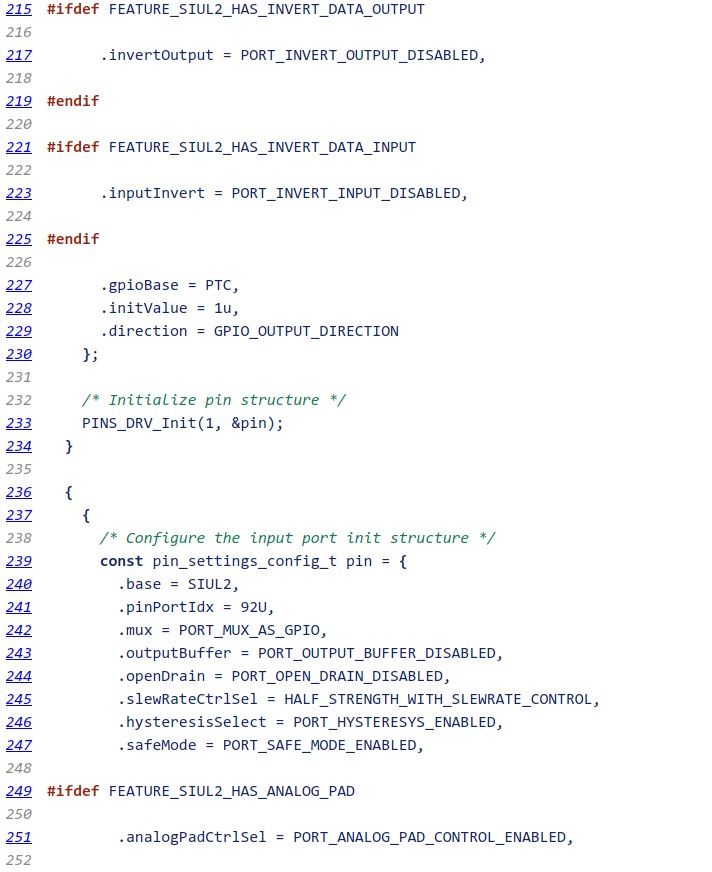

I can flash the Bootloader(MPC574xP_S32DS_UART0_CAN0_OpenSDA_RevE.rbf) on the  board.I can see the process (Earsing - APP0%-APP100%) when i download the generated code directly from simulink.
Then i flash the generated elf file on the board using S32DS and the result is same with download the generated code directly from simulink.
I think the promble might be the generated code , because i have tired another code writted in S32DS , and the RGB LED can work correctly.
Now, i still don't know where the problem is.

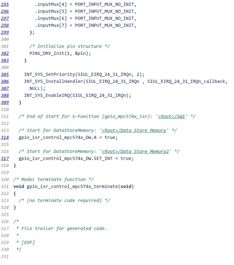

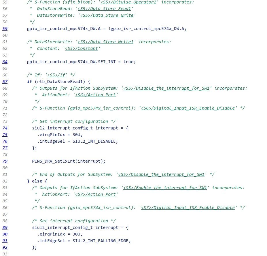

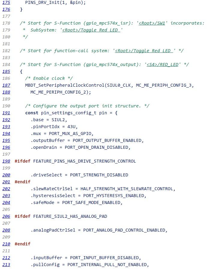

批注 2020-02-13 173942.jpg批注 2020-02-13 174110.jpg1.jpg2.jpg3.jpg4.jpg5.jpg6.jpg7.jpg8.jpg

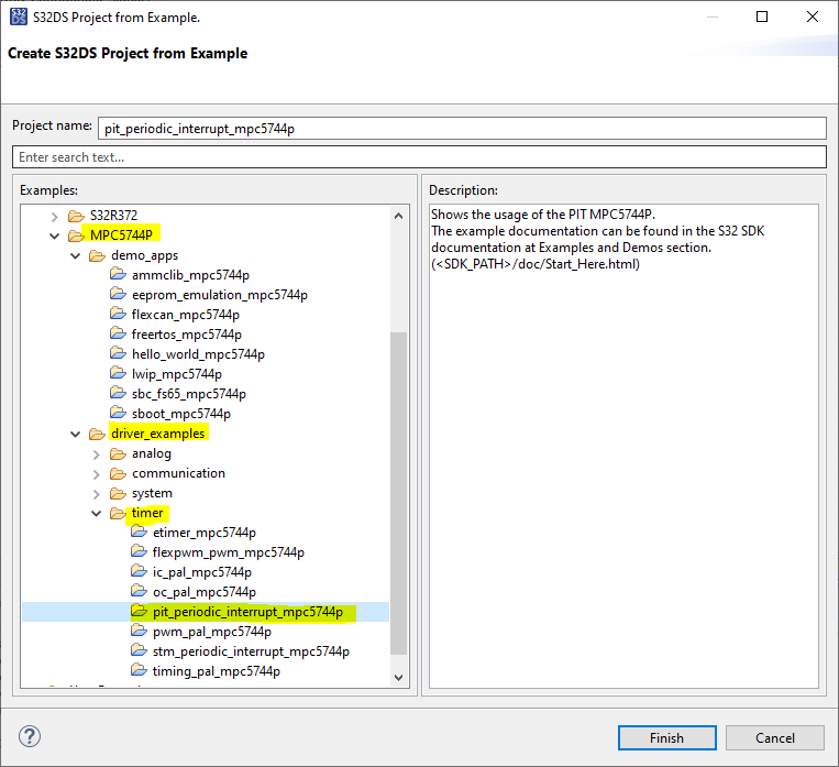

What code have you tried? It was using the external or the internal oscillator for clock source?
I am asking this because lately I found a board when it looks like the external clock was not working. The MBDT is using the external clock in order to run the core at maximum 200MHz.
Please import the pit_periodic_interrupt_mpc5744p SDK example to see if the board is running well. This example is using the external clock oscillator.
The attached image shows where to find the example that I am referring to.

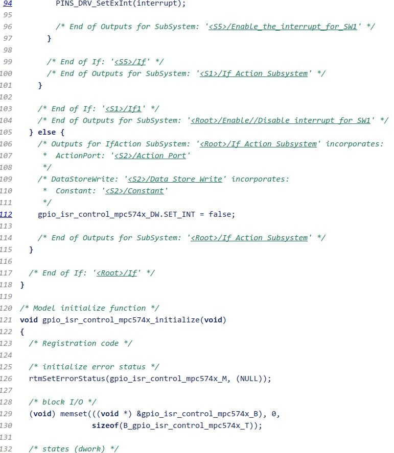

My apologies! From the first message I understand that the generated code is not running at all on your board, so you can ignore my previous message.

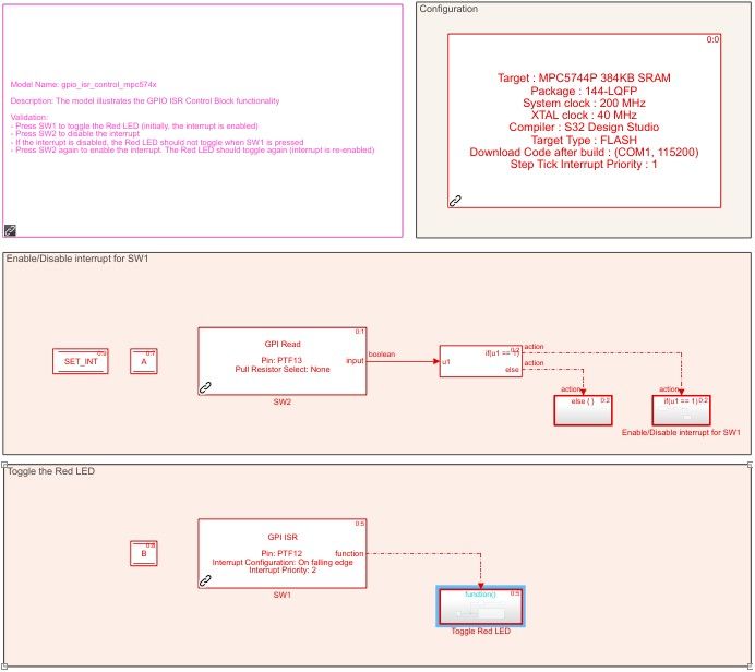

The code and the model you sent me seems to have the correct settings and the code seems to be generated correctly.
I also generated and tested the model that you mentioned and the description looks to be correct: SW1 toggles the RED LED while the SW2 enables or disable the SW1 interrupt. I also attached the mot file generated so we can test on the same mot file.
Marius
