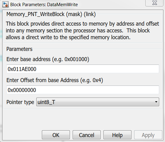

I would like to store some data on the flash of my MPC5744p, and to be able to keep them after a reset.
I follow advises from this post : How to manage the memory using the simulink?  (method 2)
I modified "MPC5744P_FLASH.ld" :
MEMORY {
    word                :           org = 0x00FA0000, len = 0x0000001F
    int_flash           :           org = 0x00FA0020, len = 0x0020DFE0
    m_dflash            :           org = 0x011AE000, len = 0x00050000
    vector_table        :           org = 0x011FE000, len = 0x00001000
    exception_handlers  :           org = 0x011FF000, len = 0x00001000
    int_sram            :           org = 0x40000000, len = 0x0005F800
    stack_ram           :           org = 0x4005F800, len = 0x00000800
    local_sram          :           org = 0x50800000, len = 0x00010000
SECTIONS
    .dflash : { KEEP (*(.dflash)) } > m_dflash  /* place .dflash section into dflsah memory*/
Point on it in the Matlab configuration, and checked modification in the generated ".map"
In Simulink I have a DataMemRead and a DataMemWrite block with this configuration :
To test, I configure the Write box to write the data from a CAN Signal, on trigger. And I read it on a second CAN signal.
I generate the ".elf" with Simulink, and use S32 Design Studio to flash on the board.
It works until this point.
But I can't view my data on the "Memory" View of S32 :
And after a reset my read data is always "0xFF".
If someone has a clue... :smileywink:
Adrien.

My 2 cents on this - i think it can only works with RAM addresses since for writing in flash we need special instructions.

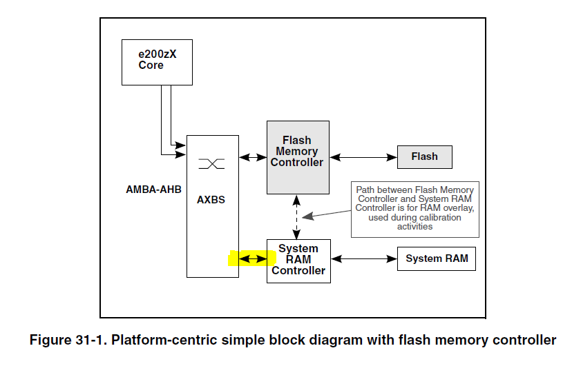

But just to understand, I found this Figure on the "MPC5744PRM.pdf"
With the MBD ToolBox blocks DataMem, we are using the yellow "link" ?
So to read/write in the Flash we would need an other block/function to be able to use the "Flash Memory Controller" ?

You and dumitru-daniel.popa are right - you will be needing another block to be able to use the flash memory controller to program(0)/erase(1) bits into flash.
And regarding the DataMem block, it does use the "yellow link" as described by you (the system RAM controller).
Unfortunately we do not have such a block for now, but you can import the example from the SDK for MPC5744x that comes with the S32 Design Studio - it shows how to use FLASH_DRV* functions to program and erase flash. You can find more documentation in
 [Install Folder]\S32DS_Power_v2017.R1\S32DS\S32_SDK_MPC574xx_EAR_0.8.2\doc\Start_here.html
(Click on Modules -> Flash Memory and see all the functions the SDK provides)
