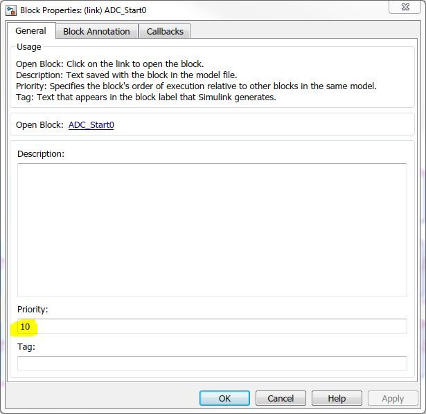

Simulink generates the code by ordering the blocks after some priorities that can be edited by right clicking the block and adding a number like in the figure 1.
Fig. 1. Changing the Block priority
In your model, the conversions were scheduled like in the figure 2. The program was waiting to get the value from the channel ADCA_CH6B(priority 16) but the ADC_Start2 block was never called (priority 55) so no conversion was started. This was happening because some blocks had some priorities, others none.
Fig. 2. Bad block priorities
The ADC should work like this: the ADC_Start0 must tigger a conversion and after it is done, the blocks under the ADC_Start0 must put the values in V_in and U_dcb/2 values. Next the ADC_Start1 triggers another conversion and so on. We reordered the blocks like in the figure 3.

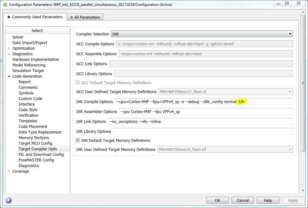

Now, we found another problem caused by the IAR compiler, which reordered some program lines while otimizing the code. We fixed this by changing the optimization -Oh flag with   -Ol or completely removing it. To test this you can change it on the Target Compiler Opts as in figure 4.
Fig. 4 Changing the optimization flag

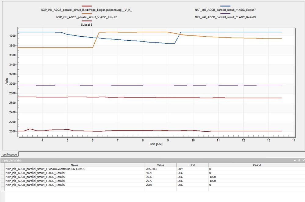

Finally, we were able to read some converted values using Freemaster.
Fig 5. Freemaster reading ADCB values.

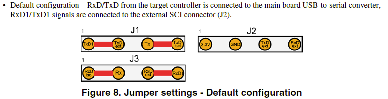

We have modified your example and we were able to successfully read some ADCB converted values with Freemaster, so I attached the modified example. If you will run it, please be aware that in order to read data using Freemaster we had to change your fault PTE1 pin with PTE2 (PTE1 is the TxD pin on UART1 used by Freemaster).
This is because I use UART0 Pins PTD6 and PTD7 for FreeMASTER communication.
The Jumper setting is like it is described in the user guide. So I can connect a potentiometer at J2_TxD
Is there a reason for starting with priority 10 ?
For example the PWM_Three_Phase_Output has the same priority 10.
How can I synchronize the ADC conversation with the PWM Output Block, so that the conversation definitly isn't started in the rising or falling edge ?
3,133 Views
Daniel_Popa
Hi lethuer‌,
There is no particular reason of starting with 10. All you need to consider is the order to blocks execution in Simulink. The order should follow the logical flow and you can alter that based on block priorities.
